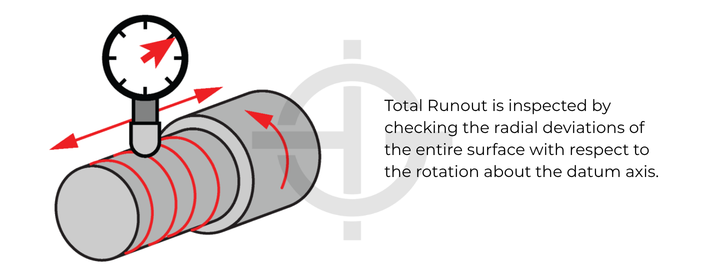

Total Runout is how much one entire feature or surface varies with respect to a datum when the part is rotated 360° around the datum axis. Total runout controls both the amount of variation in the surface as the part is rotated, but the amount of variation in the axial dimension. Both radial variation and axial variation are measured and held within the tolerance. Total Runout is usually called on a part that is rotated about an axis where the entire surface is critical to be in spec.

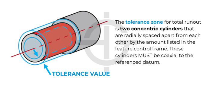

GD&T Tolerance Zone:
A 3-Dimensional cylindrical tolerance zone that surrounding a referenced surface that is directly derived from either the datum surface or the axis. All points along the surface must fall within this zone when the part is rotated at all times.
Gauging / Measurement:

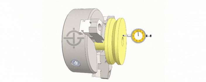

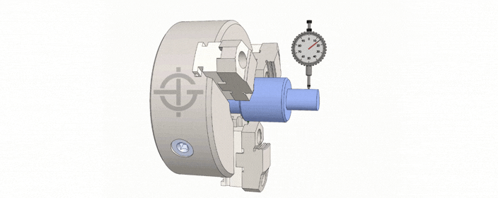

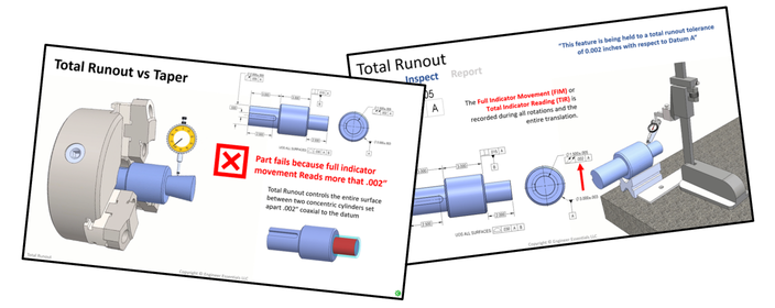

Total Runout is measured by fixing the datum features (typically an axis) and rotating the part along the rotational axis. The part is usually constrained with a set of V-blocks or a spindle of some sort that will constrain the part while allowing it to rotate. To measure total runout, a series of gauges must be linked to take their measurement in reference to each other – similar to how cylindricity is measured.
Another method for measuring total runout is to take one gauge held perpendicular to the surface of the part, and slowly move it across the surface of the part axially as the part is rotated. If the gauge varies at any point by more than the total runout tolerance, the part would be out of spec.

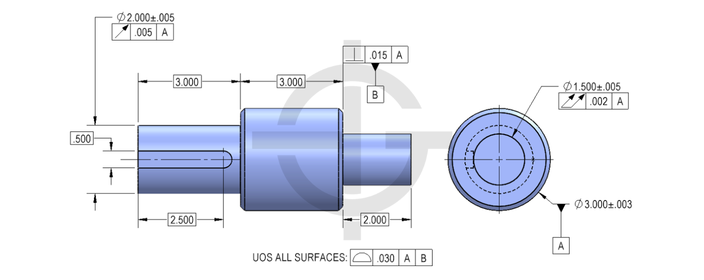

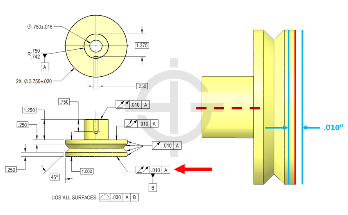

An axle is normally under high stress and needs to fit evenly in a bushing (not shown). If the referenced surface does not make even, stable contact with the housing bushings the axle will wear unevenly leading to eventual failure. Surface ‘A’(datum) is controlled with a roller bearing and should be axially aligned with the reference surface. Total Runout is called in the same way as Runout.

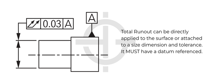

Referenced Feature is the entire surface for Total Runout.
Similar to Runout total Runout allows the final specification or condition of the part to be called out, thus controlling how the part reacts when it is rotated. The gauge to check this part for total runout would also be nearly identical as the normal runout gauge. The only difference would be that if you moved the gauge up and down the part, or had multiple gauges all fixed to each other, the total gauge indication along the entire surface could not be out.
Gauging the entire surface

Yes, you can use total runout to control a flat face that is normal to the datum axis. When you apply runout to a flat face you’re controlling the wobble of the surface. Assuming that you’re shaft is your datum and your’e attempting to control a thrust face normal to that datum you’re tolerance zone (if using total runout) is simply two parallel planes normal to the datum axis. Note that the runout control in this manner would also restrict flatness. I’ll also point out that while you can do this, it’s much more straightforward and common to see this face controlled with perpendicularity. Preference and common use in your particular industry I suppose.

Can you correct the first picture, please? (Total) run out is not applied to axis!
And… why you have added diameter symbol in your example picture? What this it means?
Correct – This was a carry over from concentricity and we forgot to remove the Ø symbol. Runout never uses the diameter symbol. Only Straightness (cylindrical feature of size), axial orientation, axial true position and concentricity should use this. Thanks for spotting the mistake!

Why in the picture you’re saying that gauge cannot vary more than 30 microns ? while FCF states for 0.2 maximum (assuming are mm) this would be 200 microns variation right?… (or maybe 1 micron isn’t 0.001mm? ) you may be using different units conversion; please help me to understand, thanks.
Sorry for the confusion – It was a typo. The example should be fixed now to reflect 200 microns/ 0.2 mm of total runout.

2. Total runout is a little more difficult to measure because your height gauge must remain at a fixed height and normal to the surface you are measuring. It is often enough to control runout alone for many functions, and then specify a straightness (or angularity for a taper) tolerance, to ensure the form is consistent along the surface.
3. Total Runout is a technical term from the ASME and ISO GD&T standard that we described above. However, when you hear the term “total indicated runout”, usually it is referring the combination of angular runout (if you have a drill bit cocked at an angle while it is rotating) and radial runout/concentricity. (how offset the drill bit is from the chuck or collet). This is refered to as total indicated runout because it is a combination of both these components. It is a common industry term equivalent to just the basic term “runout” .
