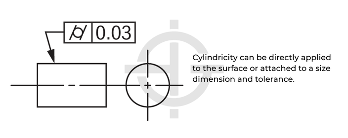

Drawing Callout:
Description:

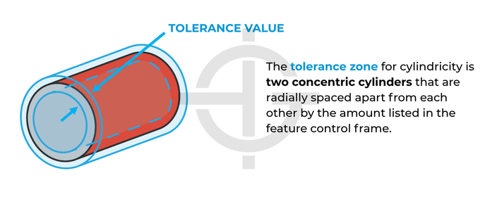

The Cylindricity symbol is used to describe how close an object conforms to a true cylinder. Cylindricity is a 3-Dimensional tolerance that controls the overall form of a cylindrical feature to ensure that it is round enough and straight enough along its axis. Cylindricity is independent of any datum feature the tolerance needs to be less than the diameter dimensional tolerance of the part. Cylindricity essentially forms a perfect cylindrical boundary around the object that the entire 3-Dimensional part must lie in.
GD&T Tolerance Zone:

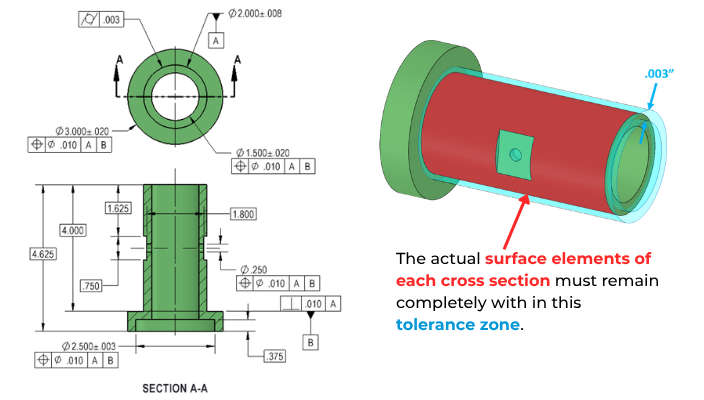

Two concentric cylinders that run the entire length of the feature – one inner and one outer, in which all the points on the entire surface of the cylindrical feature must fall into. The entire length of the called out feature would be controlled.

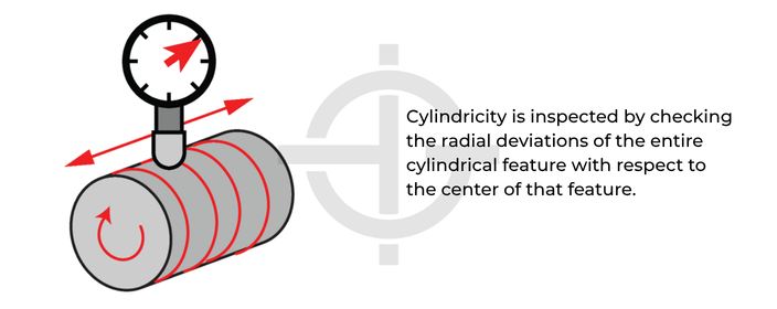

 Gauging / Measurement:
Cylindricity is measured by constraining a part on its axis, and rotating it around while a height gauge records the variation of the surface in several locations along the length. The height gauge must have total variation less than the tolerance amount.
Cylindricity is a merger of circularity and surface straightness. It is the 3-Dimensional version of circularity along an entire cylinder length. While circularity only is concerned with individual measurements around the surface in one circle, cylindricity takes into account how straight the axial portion of the cylinder is. Thinking of stack of coins, cylindricity would measure to make sure that the entire stack is straight up and that every coin is round. Circularity would only be measurements of the roundness of the individual coins.

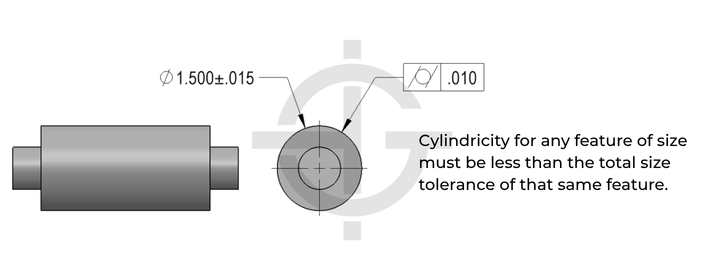

If you had a bushing that was to be pressed into a housing, the bushing would take the form of the housing bore when inserted. To ensure that the bushing maintains its round shape, and wears evenly along its surface, the housing bore needs to be very cylindrical. To do this without Geometric Dimensioning and Tolerancing you would need very tight dimensions on the diameter of the bore, which may be very hard to control when being machined (and expensive)
Cylindricity example 1: Controlling cylindricity without GD&T Symbol
 Controlling the circularity and the straightness of the bore with cylindricity.
This GD&T control allows the diameter tolerances of the part to be opened up much larger, and better controls the entire length of the bore. You can now accept a much broader range of hole sizes as long as the cylindricity is met.

Can I use cylindricity toleance on an edge round? I’d guess not based on previous answers. What ff I want to ensure straightness and roundness along the length of e.g. a 90 degree round on the edge of a sliding part?
yes this is acceptable, but more commonly done with surface profile.

Hallo, in the Cylindricity example 1: Controlling cylindricity without GD&T Symbol, you put Φ10.0±0.04 that imply a cilindricity of 0.08, but the radial distance between the maximum and minimum size of the cylinders is 0.04 in radial direction. (Max Radius = 5.02; Min Radius = 4.98) ∆Radius = 0.04 = Cilindricity tolerance implied. Am I wrong?
Best regards and compliments for your site.
Paolo –
This can be a little confusing so hang with me. Without a cylindricity control you are relying on size to control cylindricity for you. Recall Rule #1, perfect form at MMC. As your part departs from MMC your part is allowed a form error equal to the amount of departure.
Keeping with our example. The tolerance zone for cylindricity is two co-axial cylinders. As long as all portions of the surface of the cylinder are within this zone the part is good. Well, what are the sizes of these two co-axial cylinders? Remember, we’re dealing with form here not location. The larger cylinder is easy to define, it’s equal to 10.04. The smaller cylinder tolerance zone has a diameter of 9.88. Now, what is the smallest cylinder that fits between the co-axial cylindrical tolerance zones while meeting the size tolerance requirement? The answer is 9.96 which happens to be 10 – 0.04!
How does this work? Recall that I said that location was not being controlled? The part is allowed to ‘float’ within the zone defined by the two co-axial cylinders. There are 3 stipulations: 1 – The part must remain within its size tolerance. 2 – No element of the part may cross over the zone defined by the larger cylinder. 3 – No element of the part may cross into the zone determined by the smaller cylinder.
Draw on a piece of paper two concentric circles. The inner circle has a radius of 4.94 and the outer circle has a radius of 5.02. Now, draw a third circle such that the left edge is at -4.94 on the x-axis and the right edge is at 5.02 on the x-axis (the center of the 3rd circle must be on the x-axis). The diameter of this third circle? 9.96, the LMC limit of your part.
I hope this clears things up. Best of luck.
Cheers,
Matt

Cylindricity should never use the diameter symbol (the tolerance zone is the distance between tow coaxial cylinders.)

Cylindricity is how well the part’s form adheres to a perfect cylinder. It takes into account straightness and roundness of the surface already. Example two can only have 0.08 of cylindricity since it is called out, the diameter though can increase in size.
