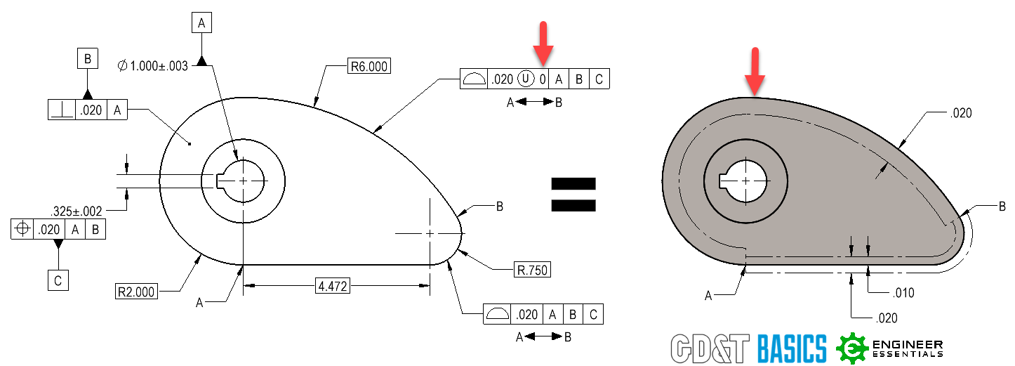

The Unequally Disposed Profile Tolerance Symbol is only ever seen when used in conjunction with the Geometric Dimensioning and Tolerancing symbols for profile of a surface and profile of a line. The unequally disposed symbol is used to apply unilateral or unequal tolerance zones to a profile of a part.
Unequally Disposed Profile FCF
Above is an example of a how the unequally disposed profile symbol is used in a feature control frame.
A) Total tolerance of the profile
B) Unequally disposed profile symbol
C) Portion of total tolerance that lies outside of the part
The unequally disposed profile symbol is placed directly after the profile tolerance value. As always, the value after the profile symbol is the TOTAL tolerance applied to the surface. However, when using the unequally disposed symbol, a second value is added after the unequally disposed profile symbol. This value is the amount of the total tolerance that lies outside of the material.
When the unequally disposed profile symbol is used in the feature control frame (FCF) as shown below, the tolerance zone will be unequally disposed about the true profile. See below:
Unequally Disposed Profile Figure 1
To further clarify, if this value equals the total profile tolerance, then all of the total profile tolerance is located outside of the material. This is commonly known as a unilateral tolerance zone. See below:
Unequally Disposed Profile Figure 2
Conversely if the value that follows the unequally disposed profile symbol is zero, then all of the total profile tolerance lies inside the material. This is also commonly known as a unilateral tolerance zone.  See below:
Unequally Disposed Profile Figure 3
