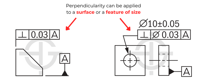

GD&T Drawing Callout:
Surface Perpendicularity:
Axis Perpendicularity:
Description:
Surface:

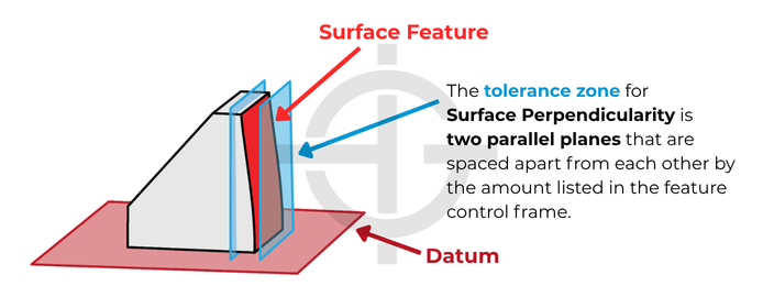

Perpendicularity is a fairly common symbol that requires the referenced surface or line to be perpendicular or 90° from a datum surface or line. Perpendicularity can reference a 2D line, but more commonly it describes the orientation of one surface plane perpendicular to another datum plane. The tolerance of the perpendicularity callout indirectly controls the 90° angle between the parts by controlling the location where the surfaces have to lie. See the tolerance zone below for more details.
Note: Perpendicularity does not control the angle of the referenced feature –the tolerance is in distance units. (mm/in)
Axis:
Axis control can also be called out for Perpendicularity and is one of the more common forms of axes call outs. When it is referenced for a circular feature, the feature control frame will contain the diameter (Ø) symbol. Axis Perpendicularity can be applied to a positive feature (pin/boss) or to a negative feature (a hole). When Perpendicularity is referenced for axial control of a feature, the symbol now specifies a cylindrical boundary where the axis of the referenced feature must lie. This cylindrical boundary is formed by taking a line that is directly perpendicular to the datum feature. When this version of Perpendicularity is called out it is to be used with maximum material condition to enable easy gauging of the part. See example 2 below for how these particular parts are gauged.

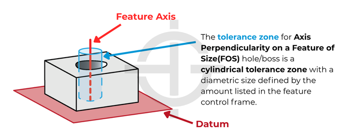

GD&T Tolerance Zone:
Surface:
Two parallel planes or lines which are oriented perpendicular to the datum feature or surface. The planes are held perpendicular to the datum, but only ensure that the entire feature falls into the tolerance zone.
Remember: Perpendicularity does not directly control the angle of the referenced surface; it controls the envelope (like flatness) where the surface needs to be.
Axis:
A cylinder surrounding a referenced theoretical axis which is directly perpendicular to the datum feature. The tolerance zone is the diameter of this symbol in which the central axis of the measured feature must lie.

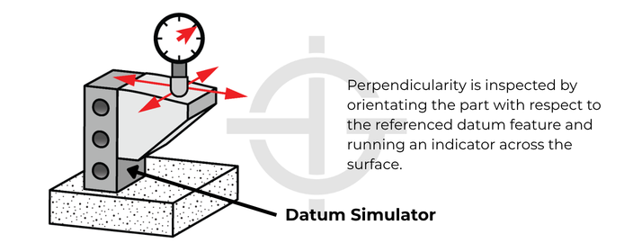

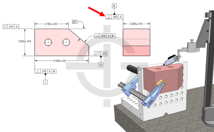

Gauging / Measurement:
Surface:
Perpendicularity is measured using a height gauge, similar to flatness, however, the gauge (or part) is locked to a 90° datum to measure how perpendicular the surface is. The entire surface has to be measured if it is a flat feature.

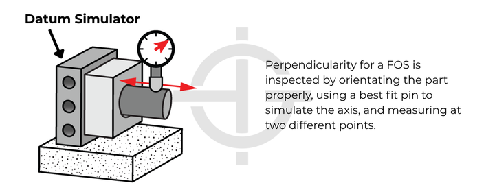

Axis:
To ensure that a part or feature is axially perpendicular, Maximum material condition is most often called out on axis perpendicularity to allow easy measurement with a gauge. This allows it to be designed for either a negative (hole) or positive (pin) feature and can take into account a bonus tolerance.*
Gauge size for an internal feature (like a hole):
Gauge Ø (pin gauge)= Min Ø of hole (MMC) – Perpendicularity Tolerance
Gauge size for an external feature (like a pin):
Gauge Ø (hole gauge) = Max Ø of pin (MMC) + Perpendicularity Tolerance
See Example #2 below for a good example Axis Perpendicularity using MMC.

Surface:
Perpendicularity is a specific form of Angularity at 90°. All of the orientation symbols (Angularity, Parallelism, and Perpendicularity) all call out the particular feature envelope referenced to a datum.
The Perpendicular Symbol is also closely related to flatness when referenced/measured surface is a surface plane. When you call out Perpendicularity, flatness is implied (you are measuring a surface variation between two parallel planes = Flatness) Perpendicularity is always measured with respect to a datum, where flatness is not.

Surface Perpendicularity Example:
The edge of a stopping block for a rail must form a 90° to ensure proper mating contact takes place. The base of the block is will be our datum and the face where the stopping block makes contact is our referenced surface. To ensure that this face is always perpendicular and flat to make good contact, you would need to both tightly control the angle and the dimensional width of the part.
Ensuring perpendicular/flat surfaces without GD&T symbol
With perpendicularity, you can open up the width dimension and control the face’s angle containing the part very tightly. Your tolerance zone remains the same, but your part is now easier to control and fabricate.
Controlling the perpendicularity with GD&T symbol.
Axis Perpendicularity Example with MMC:
If you have a critical hole feature that needs to remain parallel to the surface that is formed into, perpendicularity can be called out to ensure that the hole is straight. In this example, a bolt hole is specified to remain perpendicular to its surface.
Perpendicularity on a hole under MMC
Without an MMC callout, you would need to control just the center axis of the hole and measure it to ensure it is at 90° to the bottom surface. However, when MMC is called out on the print, you are controlling both the size and the orientation of the hole. You now can check both tolerances using a functional gauge with the following dimensions:
Formula for a perpendicularity functional gauge:
Gauge Ø (pin gauge) = Min hole Ø – Perpendicularity Tolerance
Gauge Ø = 9.9 – 0.2 = 9.7
Hole Ø + Hole Perpendicularity > 9.7 (Pin Ø) to be in spec.
Due to the Max Material Condition callout, if you have a hole that is larger than the MMC of 9.9 you will have bonus tolerance that can be added on to your perpendicularity. (According to print Hole Ø cannot be above 10.1 though)
In the example below – the hole is at the least material condition (largest hole size) with the hole at the LMC, your bonus tolerance that can be added to the perpendicularity is calculated as follows:
Bonus Tolerance = Actual Part Size – Max Material Condition
Bonus Tolerance = 10.1 – 9.9 = 0.2
Adding this bonus tolerance to your perpendicularity means your “gauged” perpendicularity tolerance can go up to 0.4 when the part is at its largest diameter.

If a perpendicularity specification is called out for a hole but with no symbol of diameter, and besides, the only datum is a line (not a plane), how can we proceed? How can we interpret this? Is it an axis perpendicularity? The drawing is ruled by ASME Y14.5.
Thanks a lot
Jorge –
If a perpendicularity specification is applied to a circular feature of size it must include a diameter symbol before the tolerance. This is in accordance with both ASME Y14.5 specs in common use (1994 and 2009). Not to throw stones but I believe the drawing to be in error. Further, having a single line (edge?) as a datum isn’t correct either. I hope you mean axis, this is really the only way this control works.
My recommendation to you would be to go back to the designer/engineer and ask for clarification and gently point out areas you are struggling with.
Now, as for what I think the engineer/designer is trying to achieve? I think they are trying to control the perpendicularity of the circular feature basically relative to a cylindrical tolerance zone. The thought process isn’t necessarily wrong, just the implementation.
I hope this helps, let me know.
Cheers,
Matt
What if i do not have access to CMM. I need to measure the perpendicularity of a hole. What is the old school method of doing this?
The easiest way to check perpendicularity of a feature without a CMM is through the use of a functional gage, where the pin of the gage is set to the virtual condition of the hole and perpendicular to the relevant datum reference frame of the gage. This won’t tell you the amount of perpendicularity error, but it will provide either a pass/fail check. This method is often used in high quantity production runs as it requires no interpretation, if it fits on the gage the part meets requirements, if it doesn’t, it fails. This assumes that you have the MMC modifier called out in the feature control frame next to the allowable tolerance.
There are a few other methods you can use to actually determine the amount of perpendicularity error, but they become somewhat complicated.

How would you measure the length of a cylinder’s perpendicularity to the center line of the cylinder? I have access to a CMM but when I try to use the tolerance buttons for it, it won’t allow that action.
TO measure axis perpendicularity, you must have a datum and then establish your axis to this. The axis is established by the software by taking measurement points of the cylinder (the more the better). I have not learned CMM programming so I cannot help you too much with the specifics.
