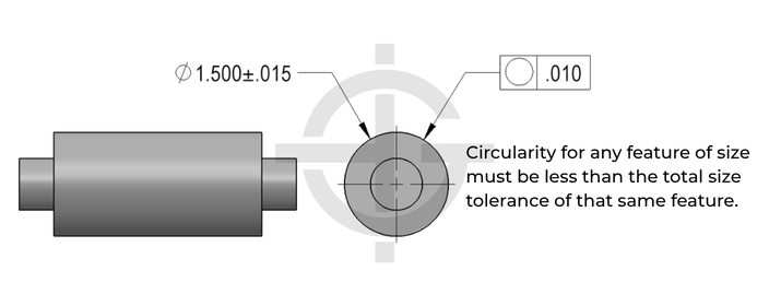

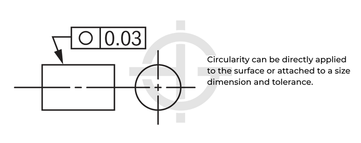

The circularity symbol is used to describe how close any given cross section of a feature should be to a true circle. Sometimes called roundness, circularity is a 2-Dimensional tolerance that controls the overall form of a circle ensuring it is not too oblong, square, or out of round.
Circularity Symbol and Callout

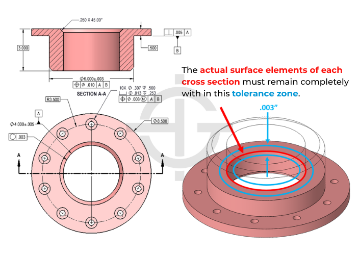

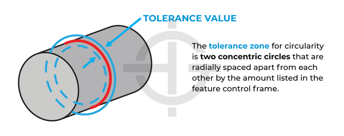

Circularity, which is often informally called “Roundness,” is independent of any datum feature. Meaning it will never control the location of a feature with respect to any datums. Circularity can be applied to cylindrical features, spherical features, and conical features both internally as well as externally. The symbol essentially takes a cross-section of the feature and determines if the circle formed in that cross-section is round. This tolerance applies to any and all cross sections of the given feature. The feature control frame can be attached directly to the feature or also attached to the size dimension and tolerance that is associated with the feature when applicable.
Circularity Tolerance Zone
The tolerance zone is two concentric circles, one inner and one outer, in which all the cross-sectional surface elements must fall within. The tolerance zone lies on a plane that is perpendicular to the central axis of the circular feature. The value of the feature control frame for the circularity tolerance is the radial distance between the two concentric circles that establish the tolerance zone.

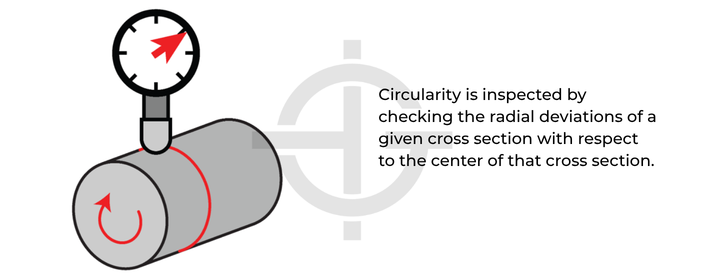

How to Inspect Circularity
Circularity is measured by constraining a part, rotating it around the central axis of the feature being controlled with circularity, while the test indicator records the variation of the surface. The indicator must have total variation less than the tolerance amount. Note that the rotation must NOT be created from any datum features but rather from the specific feature where the circularity control is applied. Due to the difficult nature of using the feature to establish rotation AND inspecting the feature at the same time, it’s best to consider, for critical situations with tight tolerances, inspecting circularity with a roundness checker or runout checking machines.

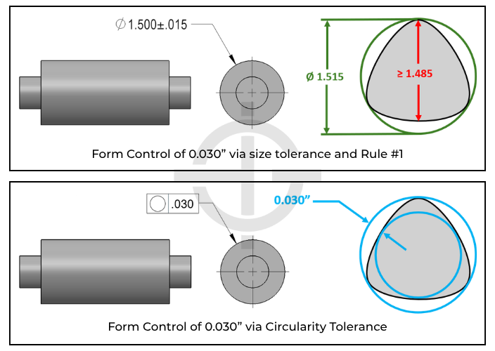

You may not realize it, but your size tolerances already control circularity. Take a look at the two examples below. They both control the “roundness” or circularity of the cross section to a maximum of 0.030 inches.
You may be thinking, “well hang on – if it is ± Ø0.015, that’s 0.030 on the diameter, which would then mean it’s 0.015 inches on the radius. How is that equal to the 0.030 inch radial measurement that circularity controls??” This is because of combination of WHERE the local two-point measurement of any cross section could be relative to the envelope of MMC. Rule #1 dictates we cannot be larger than the envelope of perfect form at MMC and our local sizes must also be larger than the LMC of our feature. So, if we subtract the LMC (the red value above) from the MMC (green value above) we would be left with the total size tolerance allowed as worse case form deviation (roundness or circularity). Which in this case is 0.030 inches.
With this in mind, we see that we could have a size tolerance of 0.030 inches, for example, however we could NOT then apply a circularity of 0.030 to the same feature. It would need to be less than the size dimension for this to be a functional tolerance.
We go into depth on this in our GD&T Fundamentals Course when we talk about Rule #1 – the Envelope Principle and how it needs to be inspected. We also cover the intricacies of circularity, how it’s interpreted, how it’s inspected and the miscellaneous things you should know about this symbol in our GD&T Fundamentals Course as well as our GD&T Inspection Course. These courses show you everything you need to know about circularity and then some!

The tolerance zone for a circularity control is two concentric circles that are radially spaced apart by the amount specified in the feature control frame. There is no size associated with the tolerance zone. The requirement is that the entirety of the surface of the part has to exist in the zone between the two circles or the part is rejected.

that’s not completely true. First example limits are 9.92-10.08 whereas the second example limits are 9.8-10.2.
The difference between the maximum and minimum OD is the same.
This is simply to show that using circularity will allow the same resultant geometric condition, while allowing for the tolerance of the OD to be opened up a bit.
You are right. It will be the same geometric condition but not the same dimensions.
Thank you so much. I was losing my mind trying to figure out how the same functional dimensions resulted from the two approaches. I think this could be more clear in the text.

Could you provide some example how people measure circularity(roundness).
Circularity is usually measured with a CMM and a rotating fixture. The CMM is able to Map out the the surface while eliminating the effect of the fixture. There is no datum for circularity so you cannot simply measure with a height gauge. Simply holding a part and rotating it would result in a runout control instead of circularity. You must have some kind of software or computer measurement to get an accurate calculation of circularity.
A CMM is not generally a good tool for measuring form type dimensions. It can be used, but you must be very aware of lobing effects from the force module. Many units such as a TP2 use an internal 3 point contact system that can cause errors in form measurements. But there are units such as the TP200 that use a strain gage technology and eliminate this effect. Just be aware.
I agree to an extent – Measuring instruments are only as good as those who use them. I would take a well experienced tech using dial indicator and adjustable gauge pins over a newly trained person with a CMM any day. It all depends on the number of points you take and your setup. Circularity and Cylindricity are tricky ones, as you really need to get a significant number of points to truly tell if the form is met.
The Renishaw strain gauge probes are certainly more advanced that simple touch probes and would probably provide a more accurate measurement. However the CMM software would still be operated properly to still achieve the correct results.
Great comment – Thanks!
In my view, CMM isn’t the right instrument to measure Circularity() unless you have a high end CMM which costs fortune.
2 Main reasons why CMM isn’t the right instrument.
1. Part remains constant and probe moves along 2 axis. (Inaccurate)
2. Alignment: In CMM part will be aligned theoretically but not physically.
When form tester/Roundness testers are used both the above points will be eliminated as the part will be rotating and probe remains constant.(Very accurate type of measurement.) and part can be aligned physically.
Anyhow the selection of instrument always depends on the Toll specified.
