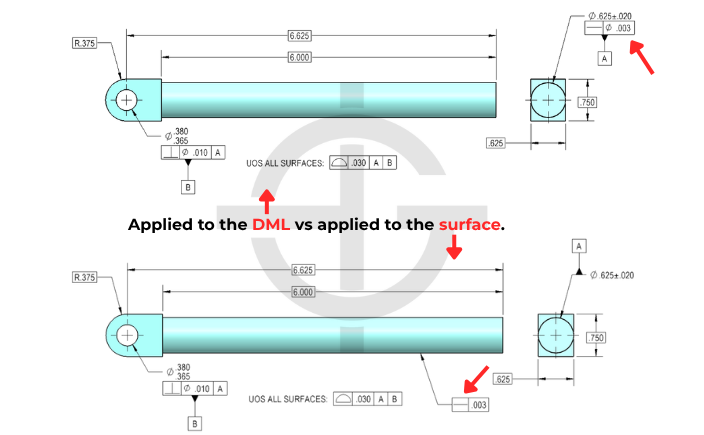

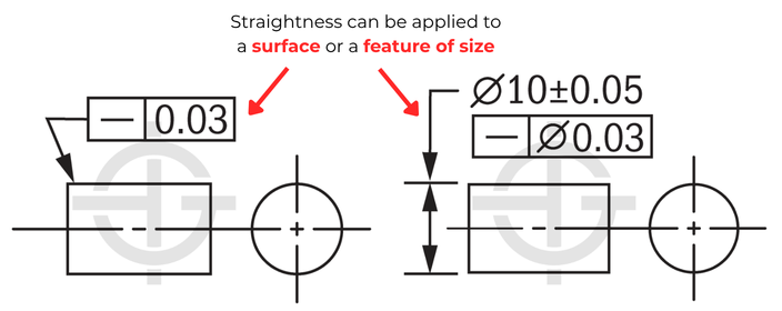

Straightness actually has two very different functions in Geometric Dimensioning and Tolerancing depending on how it is called out. In its normal form or Surface Straightness, is a tolerance that controls the form of a line somewhere on the surface or the feature.  Axis Straightness is a tolerance that controls how much curve is allowed in the part’s axis. This is usually called out with an included call to maximum material condition. Both callouts are very different from each other!

Note: Surface Straightness is called out on the surface of the part. Derived Median Line straightness is called out next to the size dimension of the axis.

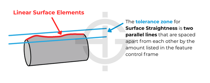

Surface Straightness:
The standard form of straightness is a 2-Dimensional tolerance that is used to ensure that a part is uniform across a surface or feature. Straightness can apply to either a flat feature such as the surface of a block, or it can apply to the surface of a cylinder along the axial direction. It is defined as the variance of the surface within a specified line on that surface.

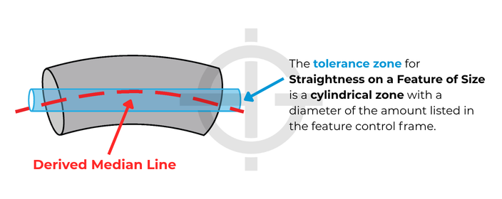

Derived Median Line Straightness:
The form of straightness that controls the bend of the central axis of a part is referred to as Derived Median Line Straightness. This tolerance callout specifies how straight the axis of a part is (usually a cylinder). By definition, DML straightness is actually a 3D tolerance that constrains the center axis of the part preventing it from bending or twisting too far.
 GD&T Tolerance Zone:
Surface:
Two Parallel Lines on either side of a surface line where the surface must lie (2D)
Surface Straightness Tolerance Zone
Derived Median Line:
A cylindrical boundary around the true central axis of the part, where the derived median line of the part must fit into.
FOS Straightness Tolerance Zone

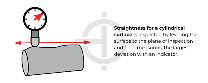

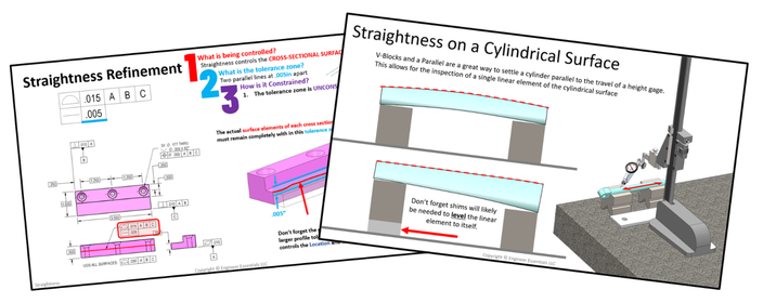

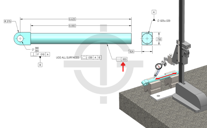

Gauging / Measurement:
Surface:
A part is constrained and a gage measures along a straight line. In this example, the height variance is measured to see how flat or straight the line is along this surface.
Straightness Surface Gauging

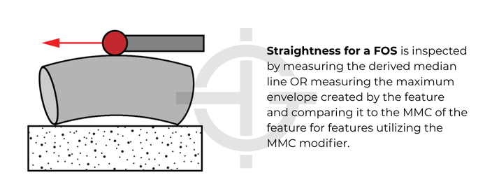

To gage axis straightness effectively, the MMC modifier is sometimes called out on the drawing. To ensure that a part or feature is axially straight, a cylinder gage is used to determine if the part fits in its total envelope at MMC.
Straightness MMC
This controls the combined effect of the diameter and of the axial straightness. The ID of the cylinder gage represents the maximum virtual condition of the part.
Gage Cylinder ID = Max Ø part (MMC) + Straightness Tolerance
Straightness Axis Gauging MMC
