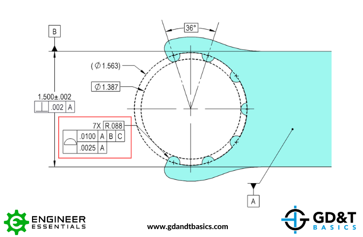

I’m working on a part right now that my QC guy and I disagree on. I watched your video on Composite Profile feature control frames and I’m pretty sure I’m checking it correctly. How do I interpret the lower portion of the feature control frame in relation to the R.088 basic dim?
Composite profile lower frame drawing example
Jason reviews the submitted drawing, above, which includes a cutout with seven radially spaced features (teeth). The surface of each tooth has a radius of .088 and a composite profile control is being applied to this pattern of features. He explains how the upper frame of the composite profile fully constrains the pattern to the datum reference frame, controlling location, orientation, and form relative to the datums. He then mocks up the composite profile lower frame tolerance zone, explaining how it refines the pattern.
Jason also introduces a modification to the drawing where the composite profile is applied between X and Y, allowing the entire cutout —including the surfaces between the teeth—to be controlled as one feature. He then explains why this alternative approach may be preferred in some applications, particularly from an inspection standpoint where a functional gage can be used to verify the cutout.
