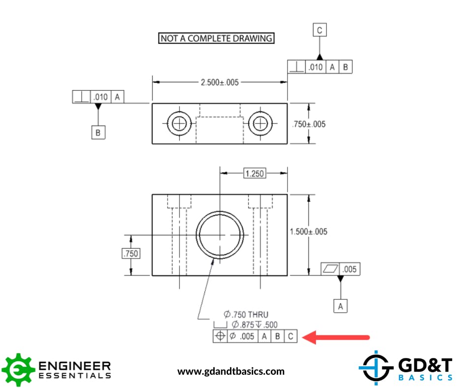

Let’s look at the example in Figure 1. In the part drawing below, we will take a look at the datum reference frame being created for the position callout indicated by the red arrow. The feature control frame for this callout references datum features A, B, and C.
Datum Feature A is the bottom surface indicated on the front view of the drawing that is being controlled by flatness. Because of how the datum feature symbol is placed, we know that it is referencing the surface which results in a planar datum. (For more information regarding Datum Feature Symbol placement, see our Datum Feature Symbol page.)
Datum Feature B is the back surface indicated on top view of the drawing. It is being controlled with perpendicularity back to Datum A. As this datum feature is also a surface, it will also result in a planar datum.
Datum Feature C is the right surface indicated on the top view of the drawing, and it is also being controlled with perpendicularity. However, it is being controlled in reference to Datum A first, then Datum B. This datum feature is also a surface, resulting in another planar datum.

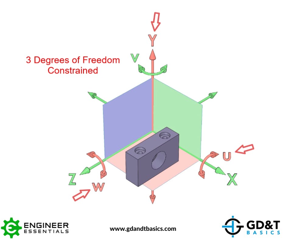

This resulting datum reference frame locks down all 6 degrees of freedom using three mutually orthogonal planar datum features. Datum A locks in three degrees of freedom (one translation: Y, and two rotations: u & w), as shown in Figure 2.

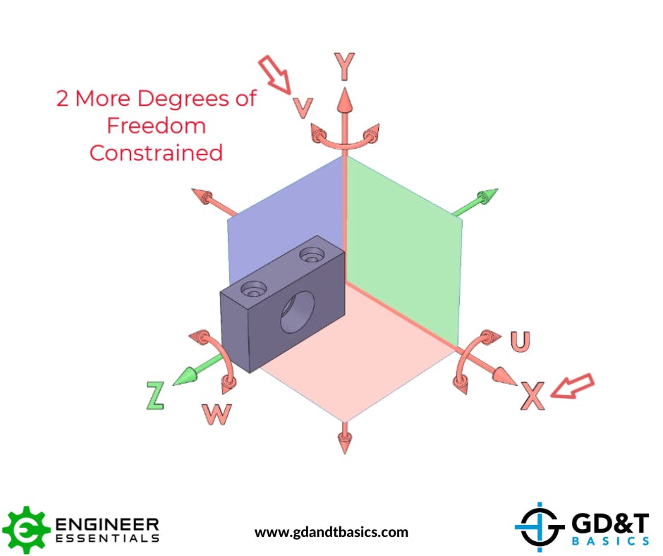

Datum B then locks down two more degrees of freedom (one translation: X, and one rotation: v), as shown in Figure 3. This leaves only one degree of freedom still open.

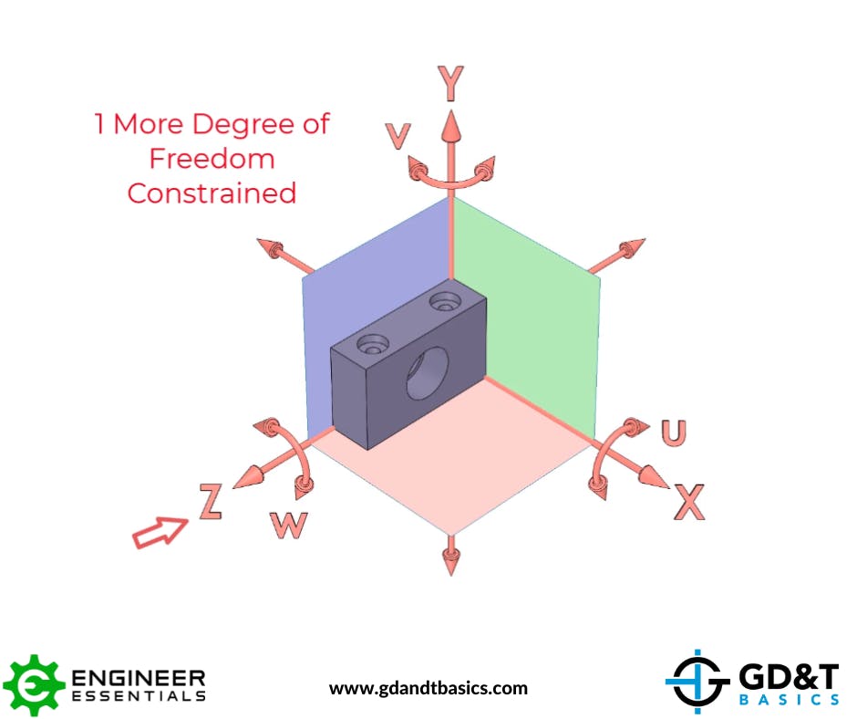

Finally, Datum C locks down this last degree of freedom (translation: Z), as shown in Figure 4.

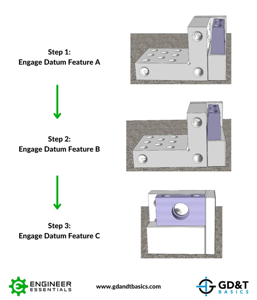

To inspect the part above, we engage Datum Feature A, then B, then C with simulated datums. (Datums are simulated by measurement equipment such as granite slabs, gage blocks, and gage pins, and computer simulated planes.)
We will go through the same process as above for constraining the manufactured part to the simulated datums to inspect the part. We will first engage Datum Feature A with the datum simulator, then Datum Feature B, and lastly, Datum Feature C. This process is illustrated in Figure 5.
Note that any other features that utilize this same datum reference frame MUST be measured before disengaging the part from this setup. This will satisfy the simultaneous requirements mentioned earlier.
