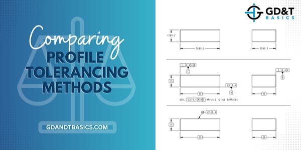

I have three questions regarding how to tolerance the profile of a part shown in the attached drawing.
  1. What are the key differences among the three profile tolerance approaches?
  2. Do they control the part to the same level of accuracy?
  3. Which method would you recommend as the preferred practice, and why?
comparing profile tolerances fig1
The submitted drawing, shown above, includes a simple part toleranced in three different ways. The first example includes size dimensions with plus/minus tolerances. The second example is controlled using flatness and perpendicularity tolerances. The third example is controlled by the profile all over symbol. Jason walks through each example describing how the tolerances control the part and explains which option provides the most clarity, most direct calculable tolerances, and most direct way of inspecting all surfaces.
