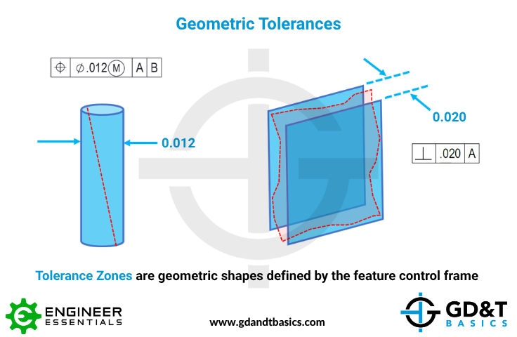

But in this Question Line video, Jason takes an even bigger step back, starting with the familiar concepts of dimensions and tolerances and building from there to explore how geometric dimensions and tolerances differ. Rather than simply establishing numerical ± limits, geometric tolerances define a geometric shape—a three-dimensional tolerance zone—within which the feature being measured must fall.
What is GD&T - Tolerance Zone examples
Jason also briefly explains that GD&T uses a standardized set of symbols and rules established by ASME and ISO to communicate these geometric dimensions and tolerances on engineering drawings.
