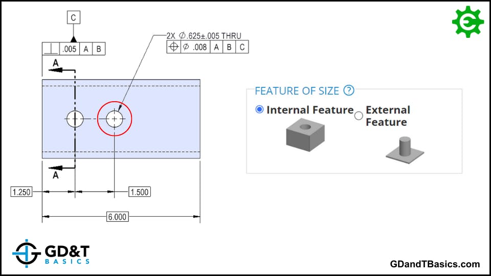

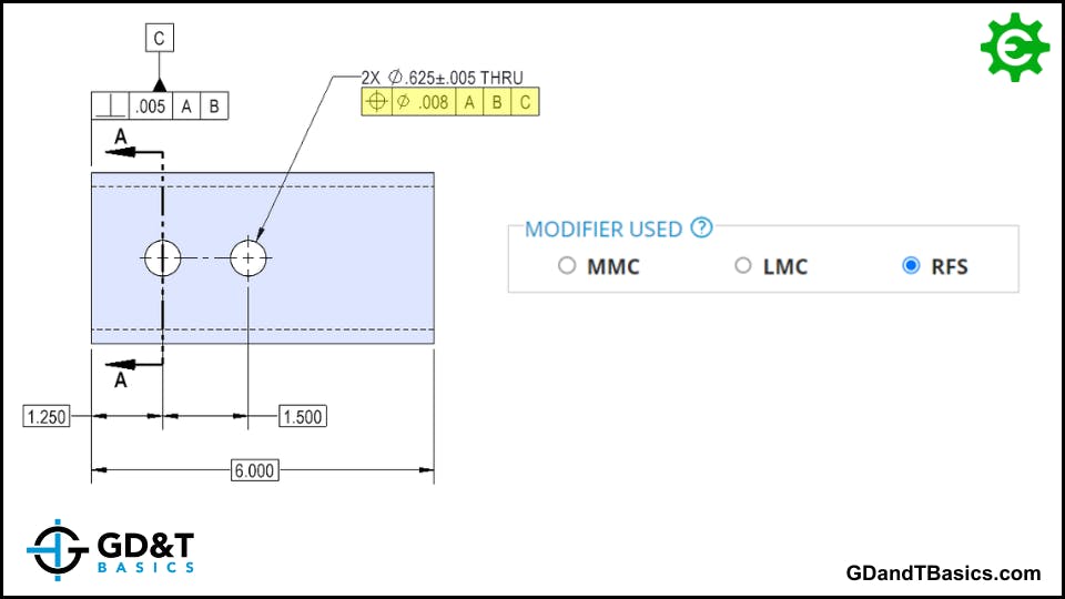

Let’s walk through an example of how to use the true position calculator for inspecting position of an internal feature at Regardless of Feature Size (RFS). In the drawing below, we have an aluminum channel with holes described by the feature control frame as having a position of .008 at RFS in reference to datums A, B, and C.
We will first enter the information pulled from our drawing.

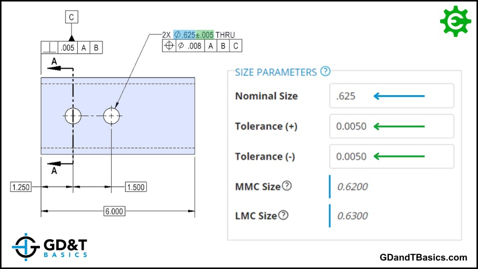

Feature of Size: We are inspecting a hole feature, so select the radio button for “Internal Feature.”
Size Parameters: Our drawing indicates a hole size of .625 with a tolerance of +/- .005. In the “Size Parameters” section, input “.625” in the “Nominal Size” box and “.005” in both the Tolerance (+) and Tolerance (-) boxes.
The calculator will then output the Maximum Material Condition (MMC) and the Least Material Condition (LMC) sizes for the hole.
Modifier Used: Select the “RFS” radio button. Our feature control frame does not have an MMC or LMC callout. When this is the case, the default is Regardless of Feature Size (RFS).

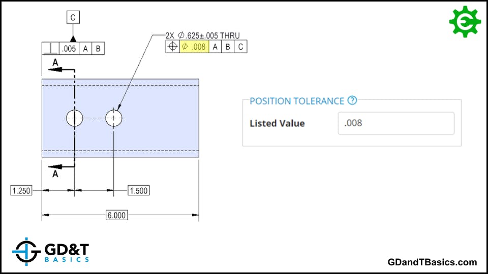

Position Tolerance: The last input from our drawing is the Position Tolerance. Input the .008 value found in our feature control frame.

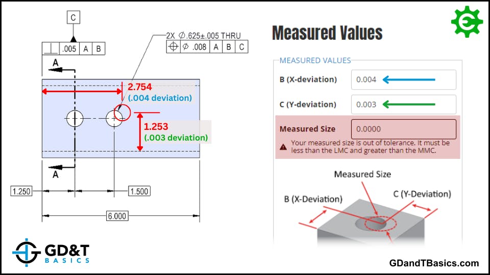

Next, we will enter the Measured Values.

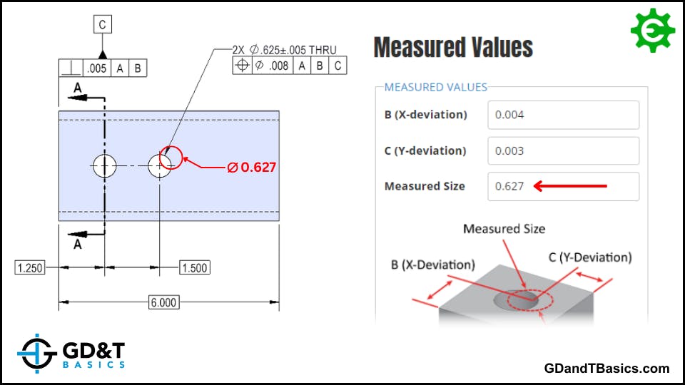

Location Measurements: Let’s say that we measured the location of this hole, and found that it measured 2.754 in the x direction, and 1.253 in the y direction. This is a deviation from true position of .004 in the x direction and .003 in the y direction.
Input .004 in the B(X-deviation) box and .003 in the C(Y-deviation) box.
Measured Size: Notice that there is an error warning for the "Measured Size" prior to entering the measured hole diameter. The calculator checks to ensure that the measured diameter is within the drawing tolerances. If it is not, you will see the box for “Measured Size” highlighted in red, with this error message for an internal feature, “Your measured size is out of tolerance. It must be less than the LMC and greater than the MMC.”
Let’s say that we measured this hole to be .627 in diameter. Enter “.627” in the “Measured Size” box. This is our last input into the calculator.

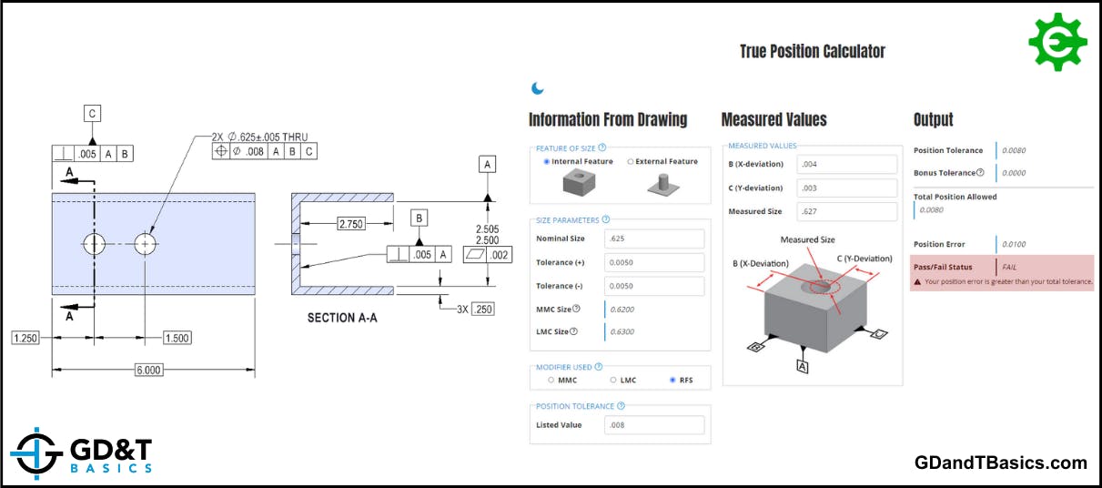

Calculated Results

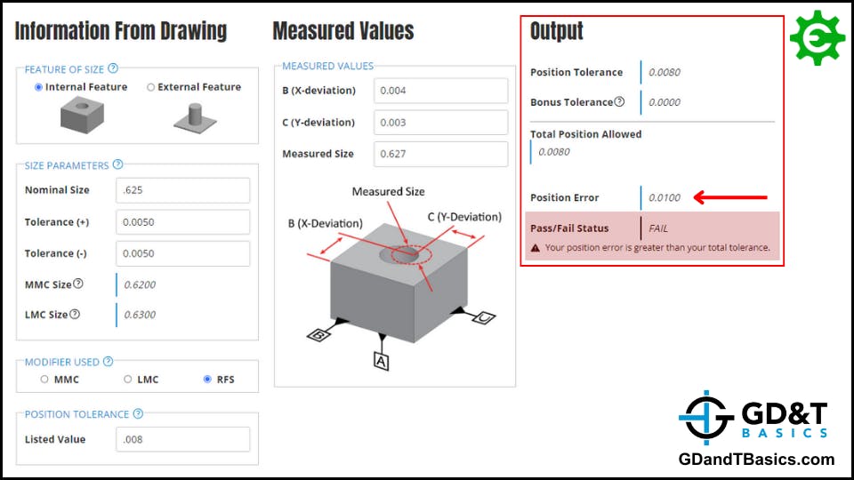

Now that we have entered our drawing dimensions and measurements into the True Position Calculator, it calculates the diametric deviation value (Position Error) and determines if it falls within the allowed tolerance zone (Total Position Allowed).

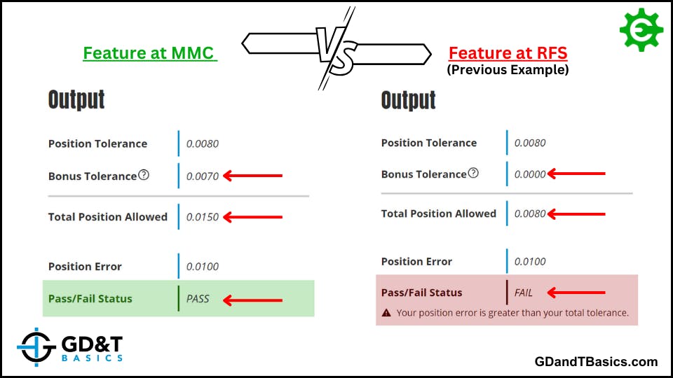

The position tolerance pulled from our feature control frame is .008. Because the feature is at RFS, there is no possible bonus tolerance. Therefore, the Total Position Allowed is equal to the position tolerance. The calculated position error equals .0100, which is greater than the total position allowed. Therefore, this feature fails inspection, as indicated in the Pass/Fail status in red.

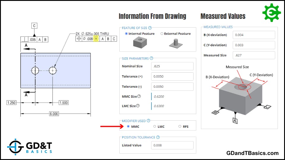

Now, let’s walk through the same example, but this time our feature control frame includes the Maximum Material Condition modifier (indicated as an “M” inside a circle). This means that the holes are being described by the feature control frame as having a position of .008 at MMC in reference to datums A, B, and C.
Calculator Inputs: All inputs from the previous example are the same, except for the selection of “Modifier Used.” In the “Modifier Used” box, select the “MMC” radio button.
With this one modification, notice the change in the calculator outputs. Designing for Maximum Material Condition allows for Bonus Tolerance, which is equal to the difference between the MMC and the actual condition (size) of the measured part.
  • For our part example, this results in a Bonus Tolerance of .007
  • When added to the Position Tolerance of .008, this results in a “Total Tolerance Allowed” of .015
  • The Position Error (diametric deviation value) of .0100 is less than the total tolerance allowed, thus the feature passes inspection. The calculator indicates “Pass” in the Pass/Fail status and highlights it in green.
