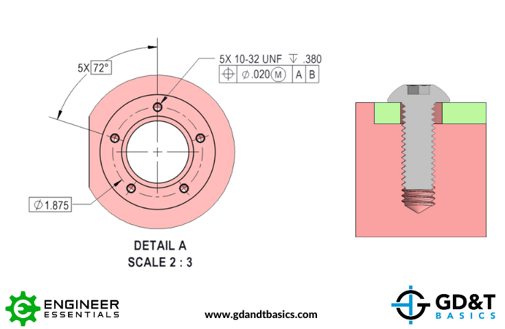

I’ve heard that it’s not good practice to use the MMC modifier on threaded features, is this true?
Model and drawing of a threaded hole controlled by position with MMC modifier
In this video, Jason breaks down what the MMC modifier does and how bonus tolerance works, walking through an example of a clearance hole. He then considers applying it to a threaded hole, shown above, discussing how the ASME standards treat thread size, what that means for measurement, and why there is minimal benefit of applying MMC on a threaded hole.
