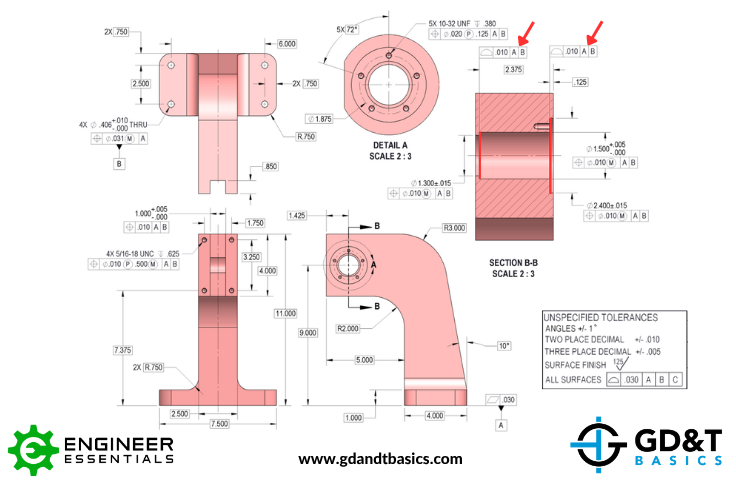

Part drawing used for linear vector tolerance calculation
The part in this example, shown above, fits into a larger assembly. The highlighted surfaces are controlled for location, orientation, and form using a profile of a surface tolerance. In this video, Jason is verifying how much profile of a surface tolerance should be allocated to those surfaces to ensure proper function without unnecessarily tightening manufacturing requirements.

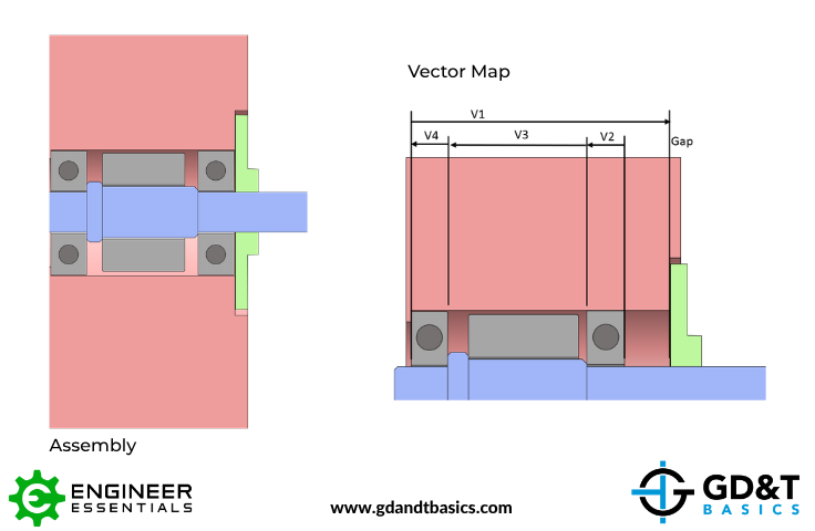

To begin, Jason examines the assembly to identify the primary function of the two surfaces and the critical functional requirements—specifically, ensuring the parts fit together while limiting the maximum allowable play. He then walks through the creation of a vector map for this assembly and performs tolerance stack-up calculations to determine whether the assembly will fit and function correctly under worst-case conditions.
Part Assembly and vector map for linear vector tolerance calculation
Check out the video for the step-by-step walkthrough of this linear vector tolerance calculation. If you’d like to learn more about tolerance stack-up calculations and the methodology behind them, our GD&T Design course provides the foundational tools and techniques needed to perform these analyses with confidence.
