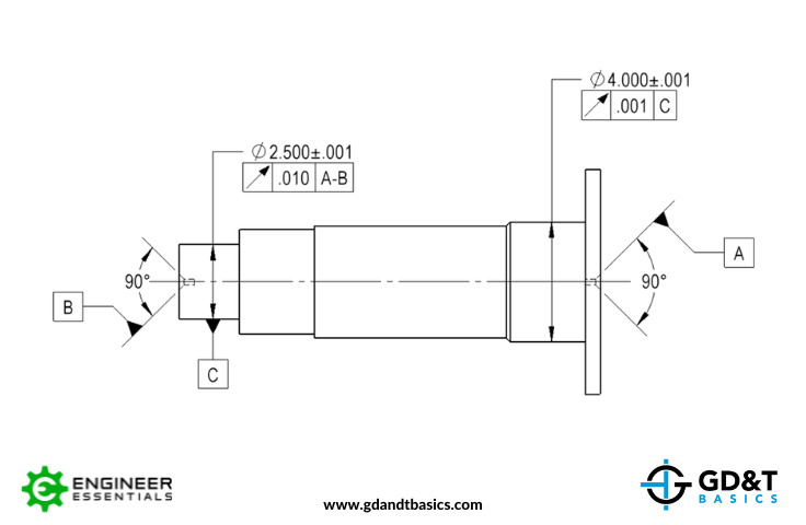

Please refer to the drawing, balloon/Parameter no.14 – there is a RUNOUT on an OD with respect to Datum C. Now my question is, if I wanted measure its Runout with respect to C, considering the part clamped between centers, and I am using an LVDT to measure this, how can I measure this parameter?
In the above simplified version of the submitted drawing, Jason notes that Datum Axis A-B is created from Datum Feature A (the cone from the left center) and Datum Feature B (the cone from the right center). The feature on the left, originally controlled to Datum Axis A-B, has been re-established as Datum Feature C.Â
In this video, Jason walks through how to use different tools and setups to inspect the runout between centers. He explains that you don’t always need to engage the Datum Feature to inspect runout to its Datum Axis—the part must simply rotate about that Datum Axis.Â
