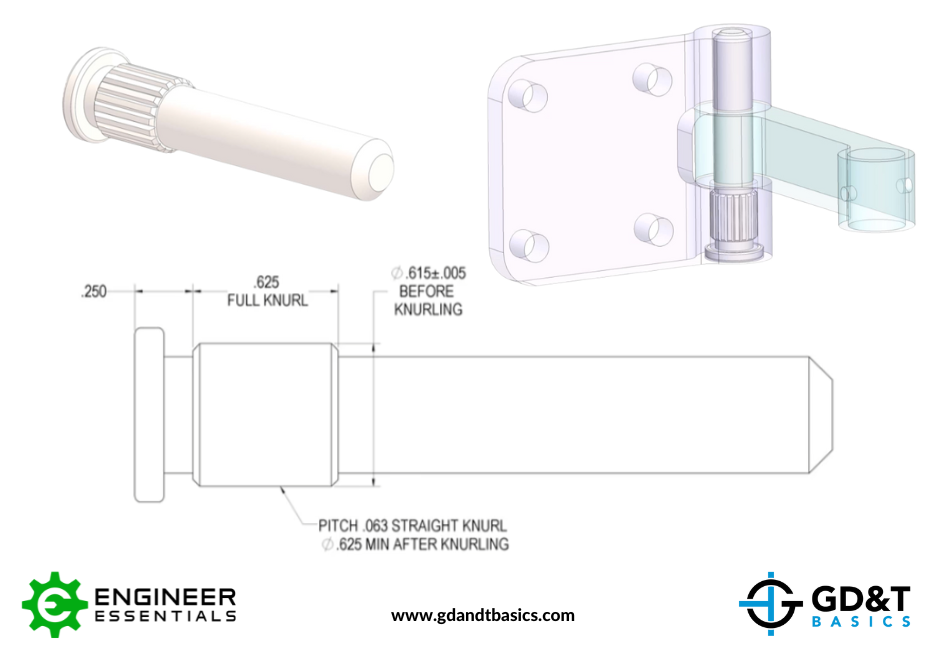

Drawing Example for an Ergonomic or Decorative Knurl
Knurling is also used for press-fit applications. When indicating a press-fit knurl on a drawing, the drawing must additionally include the toleranced diameter of the feature before knurling, and the minimum acceptable diameter of the feature after knurling (which determines how much press fit force there will be).
Drawing Example for Knurl used in a Press-Fit Application
