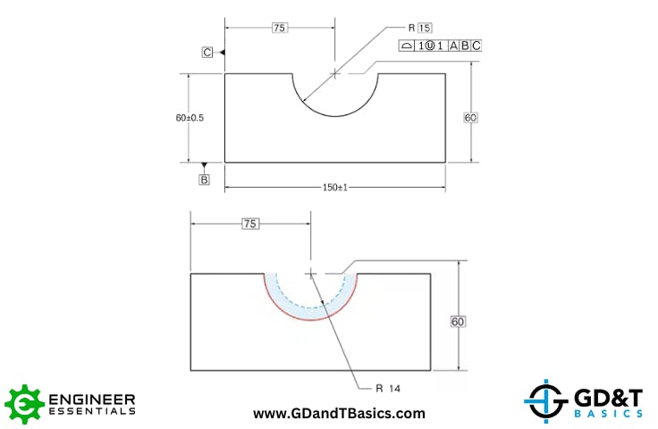

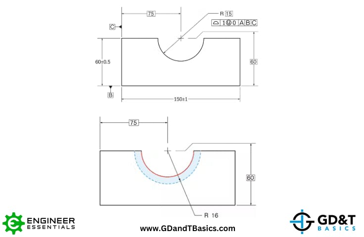

Unilateral tolerance is a type of unequally disposed tolerance where variation from the true profile is only permitted in one direction.  GD&T notation for this is identical to unequally disposed tolerance, with the number trailing the “U” symbol either zero or equal to the tolerance amount.
As you may have learned from our GD&T Fundamentals Course or other reference material, it is good practice to design parts at maximum material condition, or MMC.  MMC means using the largest possible pin or smallest possible hole within the tolerance zone.  Unilateral tolerance allows us to specify tolerances in a way that matches the thought process of our design.  Using the same example from Figure 1, we apply this concept to Figure 3 below. We want the MMC size of our radius to be 15mm, which is the basic radius dimension, so we will add “0” to the right of our “U” symbol. This means that the tolerance zone will be distributed to the inside of the feature and cannot get any smaller than 15mm but can get as large as 16mm.
Figure 3 – Unilaterally Disposed Profile Tolerance
Let’s look at one last scenario. What if we didn’t want the radius to get any larger than 15mm? As shown in Figure 4 below, if we add “1” to the right of the “U” symbol our tolerance zone will only be distributed to the outside of the true profile. Remember what we stated earlier, “the value to the right of the “U” symbol adds material”. Therefore, our radius can never be larger than the basic radius dimension of 15mm, but can get as small as 14mm, which would now be the MMC size.
