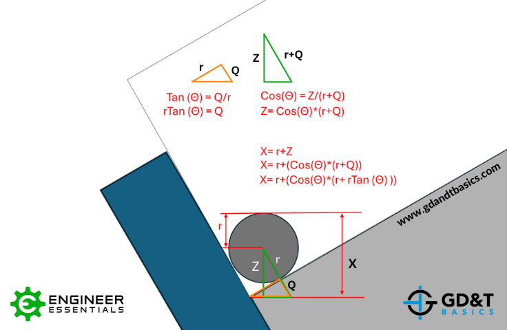

However, there is an inherent flaw when physically trying to inspect this part. When using a height gage, you are not able zero the gage at the intersection of the two planes because the probe will not settle at the zero point. Therefore, you must use a pin and trigonometry in order to offset your measurement. Figure 3 shows an enlarged view of a pin placed at the intersection of the two plates. This pin is of known diameter, and the distance from the top of the pin to the zero point will be calculated (X) to determine the amount of vertical offset for the probe measurement.
Fig 3 Pin at Intersection of Datums A and C
Figure 3: Pin is Placed at the Intersection of Datums A & C Simulators
Trigonometry is used to calculate the value for X, the vertical offset, using the known values for the pin radius and the 30-degree angle. Jason walks through these calculations in detail in the video. The resulting equations are shown in Figure 4.
Fig 4 Calculating the Vertical Offset
Figure 4: Calculating the Vertical Offset
Once the vertical offset is known, we zero our height gauge off of the top of the pin, and then we move down the X amount that we calculated to re-zero the gauge. We are now taking our height gauge measurements from the intersection of the two plates. This allows us to determine the deviation of the hole in the Y direction.
