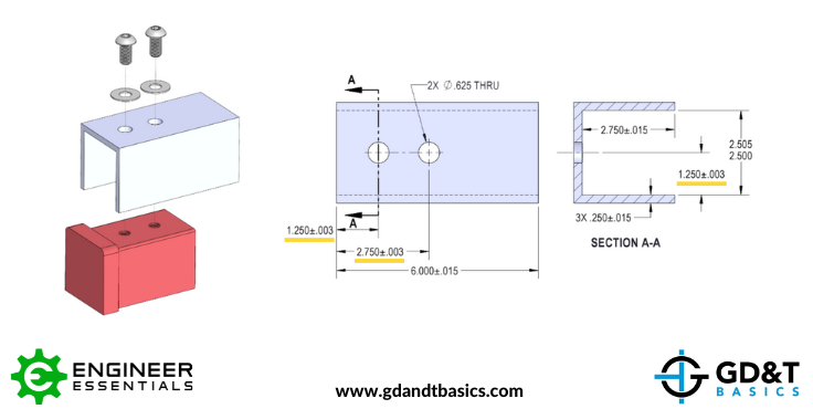

In the figure below, we have an aluminum part with two thru holes, in which fasteners will pass through and then thread into the tapped holes in the red part below it. To have a functional part, the spacing between the holes and the spacing to the edge of the part must be maintained and have appropriate tolerances. We have a coordinate dimensioned drawing for this aluminum part, and will convert it to use GD&T Position to gain the benefits of round tolerance zones.
Part Drawing with Coord Dimensions
Figure 1: Aluminum Part Drawing with Coordinate Dimensions
The coordinate dimensioned drawing gives a +/- .003 tolerance for the location of the holes in both X and Y dimensions, resulting in a square tolerance zone. To use the GD&T Position control, we will convert the allowable X and Y deviation into an equivalent diametric deviation using the Pythagorean theorem (A2+B2=C2). This calculation results in a radial deviation of .004, which we will multiply by 2 to get the diametric deviation – the allowable Position Tolerance of .008. (Alternatively, if you don’t want to do the math, you can use our handy Position Calculator!)
Pythagorean Theorem
Figure 2: Converting Coordinate Tolerances into Diametric Position Tolerance

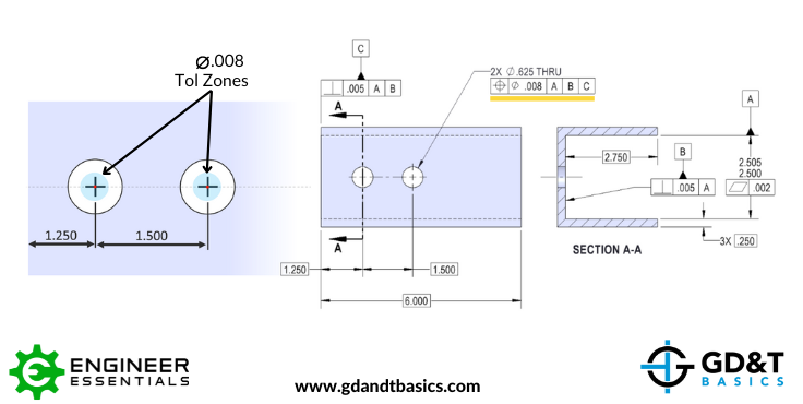

We have converted the aluminum part drawing to the GD&T drawing in Figure 3, below. This drawing now has datum features identified, includes basic dimensions for the location of the holes, and includes a feature control frame (FCF) with Position controlling the location tolerance of the holes.
Part Drawing with GDT Position
Figure 3:  Aluminum Part with GD&T Position Control

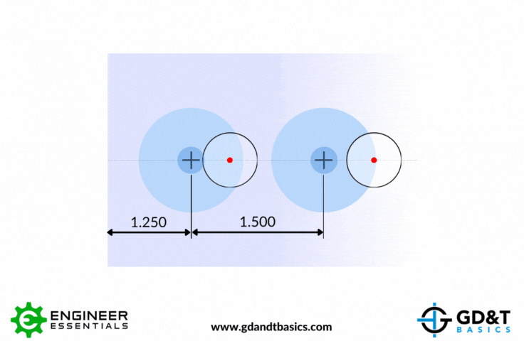

In Figure 3, we have illustrated the .008 diameter tolerance zones for the location of the two thru holes. You can see that the tolerance zones are centered at true position (the basic dimensions of 1.250 and 1.500 on the drawing). These holes can deviate in any direction as long as their axes stay inside the tolerance zones. If each hole were to deviate the max distance in opposite directions, the maximum distance between their centers would be 1.508.
Bidirectional Position Control
But what if the design intent was for bidirectional position control – for the pattern of holes to be able to shift quite a bit in the X direction while still maintaining the tighter tolerance in between holes and in the Y direction? How can we do this using GD&T Position?
