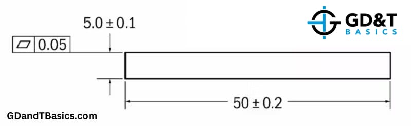

Surface flatness is the type of flatness that most people are familiar with. On a drawing, the flatness callout can point straight to the surface with a leader arrow or be extended out from the surface and away from the feature of size. As you can see in Figure 1, the surface’s flatness requirement is not in line with the size dimension. Noticing the flatness symbol’s placement is critical in determining whether the flatness requirement is for a surface or a feature of size (FOS).
Flatness Fig 1
Figure 1: Flatness of a Surface on a Drawing
Flatness of a surface is merely defining how flat a surface feature must be and is the condition of being purely planar. The flatness tolerance zone is a 3D tolerance zone, meaning that when you are checking flatness of a surface, you are checking the amount of variation up and down the y-axis over the entire plane. Figure 2 shows the tolerance zone for the surface flatness called out in the drawing in Figure 1.
flatness fig 2
Figure 2: Surface Flatness Tolerance Zone
In Figure 2, the surface being measured is shown in red. It is in tolerance if all points on the surface lie within the tolerance zone of 0.05. The cross-section shown in Figure 2 shows that as long as the surface fits between the two parallel planes of the tolerance zone, the flatness requirement is met.

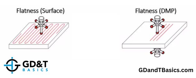

Surface flatness and Flatness DMP can both be measured using a CMM. Figure 5 illustrates how surface flatness and flatness DMP for our above examples would be found using a CMM.
Flatness Figure 5
Figure 5: Flatness Measured by a CMM
Surface flatness measured by a CMM is shown in the left side illustration of Figure 5. The probe of the CMM measures and collects points on a single surface. For the surface to be in tolerance in our example, all points on the surface must lie between two parallel planes that are 0.05 apart.
Flatness of a Feature of Size (Flatness DMP) measured by a CMM is shown on the right side illustration in Figure 5. The probe measures both sides of the part to establish the derived median points of each cross-section. The points are calculated and added together for a Derived Median Plane based on the internal software calculations of the CMM. The DMP is then compared against the tolerance zone of the two parallel planes that, in our example, are spaced at 0.05 apart. No part of the DMP is allowed to cross the tolerance zone; otherwise, the part will be out of tolerance.
